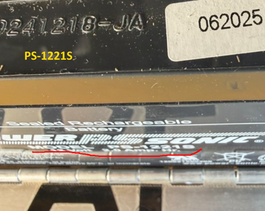

The PS-1221S battery had been replaced in October of 2025 during my conditional inspection. Normally I fly my FX3 about 120 hrs a year, but I am down to about 50 hrs a year due to work, weather and an elderly mom who has needed a lot of care recently. Prior to this attempted flight on June 6th, the plane had not flown for 3 weeks and had less than 15 hrs since January. Whether this is a factor or not, it’s worth noting. Also note the battery had a date sticker of 06/20/25 and this failure occurred on 06/06/2026.
During the run up the voltage dropped to 5.9 before I shut off the RT IGN Battery. I considered this a failed runup and returned to the hangar for diagnostics.View attachment 869
The solution to this was to replace the PS122S battery with a new one. My new SOP will be to replace that battery one year after the battery manufacturing date and not during the conditional inspection time. I have also changed my engine run up check list to include a 10 sec run on the emergency battery.

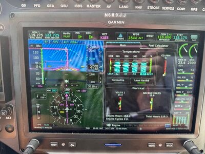

I could not help but notice your panel layout is very different from mine - If you look at my attached pic can u tell me how to match your layout
Thanks

From the Eng page, select menu until you get into the display set up.
- Once in the display set up menu, find the PFD EIR/Engine page layout. I suspect you are on Separate. I am using Combined.
- I noticed your EIR data is on the right side of the screen. It's a personal preference thing. Mine is on the left side. If you want to change that the PFD EIS Screen Side parameter is just above the PFD EIS/Engine page layout parameter.

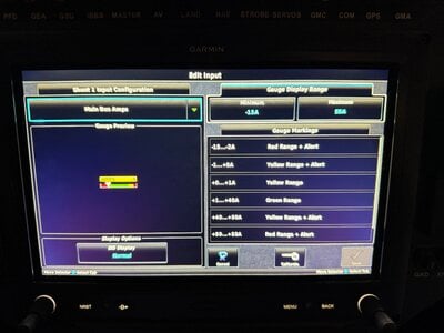

If you want to set up the Volts 1 and 2, IBBS and Amps like @Neal and I have your going to need to bring up the G3X into Config mode. NOTE - Make sure your config is backed up before making any of these changes.
- Once in config mode, scroll down to Engine & Airframe.
- scroll down to the Volts 1 and 2. I've attached photos of how I set up my alerts. Note I chose to hide Bus 1 Volts and Bus 2 Bolts on the EIS display. I Personnal think the EIS display gets too crowded with them on. YMMV.
- I set up Shunt 1 for the Main Bus Amps. This is set to show on the EIS display.

@TailwindsJJ - I managed to get out to the hangar today and take some pictures.
- Once in the display set up menu, find the PFD EIR/Engine page layout. I suspect you are on Separate. I am using Combined. View attachment 931
- Once in config mode, scroll down to Engine & Airframe.View attachment 933
Hope this helps.
