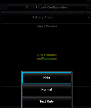

In the post immediately above yours look at the lower left of the screen capture. Display options - "Normal" will include in the side bar. Option - "Hide" will exclude it.
