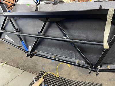

I have an EX3 and obviously have removed that center panel - be sure to put masking tape on the floor close to the bottom of the panel and mark all the rivet clip positions so the holes line up when you put it back. I added a net in that position but beware as if you fill it up the pedal could snag on the bulging net - I considered making a recessed area to make more space but it is a lot of work.
Message me if u have any questions

Thanks. Yeah, I'm aware of both left and right cargo net locations could be interference for rear passenger feet but fortunately I rarely have anyone in the back seat. My back seat is stowed other than for BFR's as my goal is to fly my dog which I've only done once. She's a lab and I just can't stomach the idea of her shedding in the plane! :) She loved it, I was the nervous one.
As to marking the snap rivets, good point. The left forward panel was a bear to get back in trying to align those and do yoga at the same time.

I have found that a couple awls of the appropriate size really makes it much much much easier to line everything up when reassembling...
