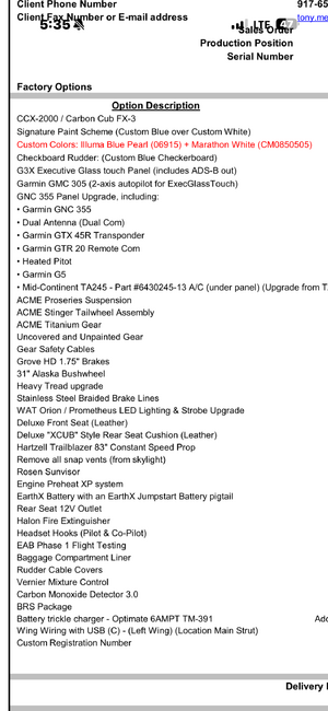

I already have the EarthX 900 spec’d with pigtails.
See latest build sheet:
