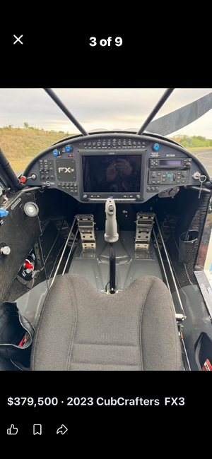

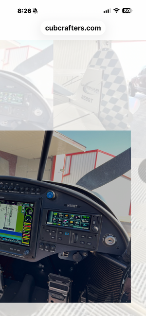

Has anyone see a FX3 IFR variant with either the 307 or 507 Garmin AP Head? My current SS has the 307 head with knobs for heading and altitude but it appears that Cub Crafters defaults to the 305 head when in IFR configuration because there is not enough space under the Garmin 355. The 307 head is nearly 0.5” taller than the 305.
I am trying to see if it’s possible to retain the 307 series head in my IFR configured FX3.
I went through the same thing wanting the 307. Apparently it's deeper and it interferes with the structure.
Neither GMC 307 nor GMC 507 fit in existing panel layout. Height is limited by the horizontal frame tube and, while not a factor for either GMC, depth of the lower position is limited by the avionics tray.
GMC 507, if there was space, would require a wiring change since it uses CANbus not RS-232 interfaces.
As long as the GDU is working it's easy to select altitude and heading with the GDU knobs. If GDU fails it's a bit more awkward to make the selections on the G5.
While the GDU is working the virtual AFCS control panel allows use of TRACK mode which cannot be selected from the GMC 305 or GMC 307.
Although there is no heading and altitude knobs on the GMC , I have the lower right knob on the PFD configured as altitude and heading so it is easy to control in the bumps.
When I am following a coastline or a river, it is nice to use track mode so you can just move the line to follow the map. Track mode needs to be enabled in the virtual AFCS panel on the PFD but if I am just avoiding traffic or an obstacle while in Nav mode (flight plan loaded from ForeFlight if not really simple) I will either hand fly or use heading mode if I am also dealing with radios, etc.
So in practice, I don’t find the lack of dedicated altitude and heading knobs an issue.
