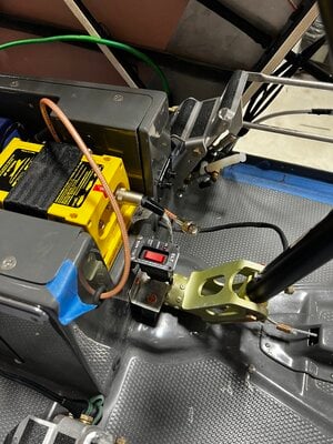

Hi Yes I have a remote ELT switch mounted forward of the ELT between the stick and the ELT makes for a much easier install and no panel space needed - my fire extinguisher is behind the pilot seat and easily reachable just in front of the rear stick on the sloped portion of the seat base Velcro attached.

I can't see them but there must be bolts securing the velcro strap to this bottom bracket. It's a flimsy setup, not how I would do it. I would bolt a typical fire extinguisher bracket to the seat base, maybe with a backing plate, assuming there is access on the other side. I imagine vibration must beat up this fire extinguisher, I may put some padding under mine now I see the issues with this setup.
P.S. what a mess, I have some cleaning to do! :(
Thanks @Neal . I agree, there must be bolts there. Can you confirm that you also have a Velcro strip applied to your fire extinguisher in order to secure it when it's in the holder? Looks like that's the case.
I'll dig into mine next week and post up pics of what I end up doing. Really appreciate it!
Yes, there is velcro on the extinguisher.
