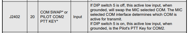

There is support for a "COM SWAP" input discrete but, unless I misunderstood, there is no provision for having front and back seat transmitting on different radios. That capability is provided in some other audio panels.
