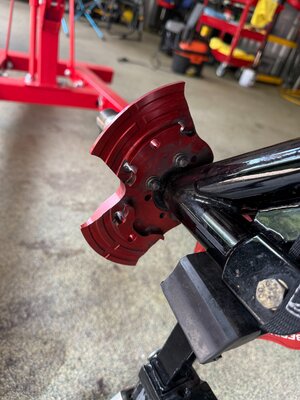

@Cubonaut875 also bought the dual calipers but has yet to install them and prior to going to Oshkosh this year he dropped his plane off with his A&P to have the dual caliper brakes installed. His A&P realized the holes weren't lining up for the bolts as outlined and only 3 would line up. And that's what I installed with mine, the 3 bolts. His A&P reached out to Pete at CubCrafters who stated 3 is insufficient. His A&P reached out to me and I mentioned it's a sheer force, and I've had no issues to date, I'm fine with it, however, is drilling out additional holes an option? He preferred the correct backing plate, as our 6-hole axles are welded per Pete, that's not an option to change, so Beringer would need to have a compatible backing plate for this axle. I find it interesting that CubCrafters specs out 4 bolts for the single caliper install on the 6 hole axle, yet in their opinion 6 bolts is needed for the dual caliper setup.
3-bolt-back.JPG backing-plate.JPG 3-bolt-front.JPG​

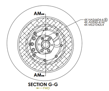

In discussion with Pete he pointed out the use of a stronger sheer force bolt (NAS...) instead of an AN bolt, which ironically is what was installed with my Beringer's from the factory it seems. So I ordered more bolts, washers, and the special nuts used in this job with intent of drilling out more holes in my install.
beringer-bolts.png​

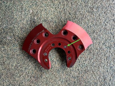

So in pulling the brakes apart for a good cleaning I drilled one additional hole (green arrow below) which is all that could be drilled. Thankfully it's in the Beringer part and not on the welded backing plate. I'd hate to screw that up! It's not the best engineering work but I now have a 4th bolt in my install. I'll reach out to Beringer about this too as they really need a proper mounting plate for the CubCrafters 6 hole axle. CubCrafters does not have engineering data for Beringer dual calipers and believes 6 bolts should be used as outlined by Beringer.
add-hole.JPG​

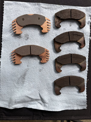

While at this I replaced my brake pads with the newer style from Beringer which they call STOL competition brake pads I believe. You can see they have cooling fins that protrude off the sides. My brake pads are probably fine but I really don't want to do this again for a long time so I'm just installing the new pads I bought when the release announcement about these came out. If I recall it's about $100 per pad (ouch).
brakes.JPG​

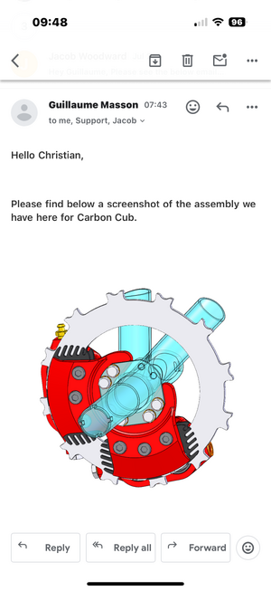

@Cubonaut875 and I have both heard back from Beringer. They say their engineering states 3 bolts is sufficient. I do suggest the NAS bolts which are higher sheer strength and if you want to add a 4th a hole will align with that but you have to be precise on your drilling and alignment.
@Cubonaut875 any updates from CC or Beringer as I understand you effected a meeting of the two to develop a plan for dual caliper Beringer installs?
Cubcrafters said they are waiting for their engineering team to come up with a solution to provide to Berringer. I'm not holding my breath, but I'm going to shake the tree again both Cubcrafters and Berringer.

Just drill that extra hole @Cubonaut875 - the dual calipers are amazing. If your A&P ever finds any evidence 4 high sheer bolts are an issue, then change to something else. I think the alternate option from CC was Grove HD's? I don't think 3 or 4 bolts for that matter is an issue. If you're going to do STOL competitions and stand on the brakes, then maybe, but doubtful, there are plenty using dual caliper brakes on Carbon Cubs even in competitions with no issue. I'm fine with it. I hope you can get them installed soon and if Beringer comes through we both can swap out to something different. Looking forward to hearing how you enjoy the brakes as I have.
I kind of have myself backed into a sticky corner. It’s experimental so I could just do it, but I would probably have to chuck the mechanic then and I kind of need him for future problems I can’t handle. And in actuality he is correct, Berlinger just needs to manufacture a plate to match the standard Cubcrafters axle as should have been done. I’ll go nuclear next week, I’ll keep you in the loop.
Given were experimental could you have someone build you the correct plate?
Definitely could, but the set up to mill and anodize two plates would be much greater than if Berringer would just fabricate a part that would apply to all the dual caliper brakes they have sold and all future that will be sold. I could easily drill a fourth hole and get around the manufacture error as Neal has done, and will probably end up doing just that in the long run, but it's a matter of principle now. I would think that the combination of Berringer brakes and 31" Bushwheels should not be sold until a plate is manufactured to allow the dual calipers to be installed without user modification or compromise. Single caliper Berringers and 31" Bushwheels is totally inadequate.
As I will need to replace my brake pads in not too distant future, I have been investigating the options with my single caliper Beringer setup and 29" Alaska Bush Wheels. I find that I have to hold very heavy brake pressure for a 1900 RPM run-up, and even then, creep forward slightly when I cycle the prop governor. For full power attempting a static takeoff, the tires drag on grass, and even with as much force as I can put on the brake pedals, the brakes drag on concrete. For maintenance purposes, I have always had to tie the tailwheel to a solid object to perform full-power run-ups.
In talking with Brian Bowen, he thinks the Beringer brake configurations are designed to just "hold" at normal static run-up RPM, not necessarily at full power to mitigate nose-over accidents. In his experience, the biggest issue with the Carbon Cubs is that the pedal geometry means only the smallest master cylinders fit, and even then, it is hard to generate the required force on them. The fluid volume of the small master cylinders is "insufficient" to support more than a single brake caliper. Some people use dual calipers, but you need to watch the fluid levels very carefully as the brake pads wear down, since there isn't much extra fluid in the system. His advice is to upgrade to the recently released "STOL" brake pads (P/N: PQ-109.6) instead of the general-purpose brake pads used in the past.
I just got off the phone with Beringer Aero USA, and they, too, recommend upgrading to the "STOL" pads, as they have had "mixed feedback" with the dual-caliper configuration but good feedback with the "STOL" pads.
So I now have a set of 4 "STOL" pads on backorder as they seem to be very popular at present...
What type of "mixed feedback" have they had? What did they say was the downside of the dual caliper system?
I bought the STOL brake pads from Brian Bowen, not cheap and I probably wasted my money but I figured why not go with the latest and greatest and best brake pads yet my dual caliper setup has never had any issue holding the brakes with my 31" bush wheels. Moral is, we really don't need to use brakes, yet I use them. The only time brakes are needed are for runup and holding short for takeoff, etc.

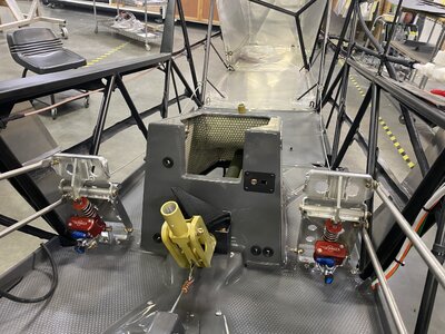

I've heard the same thing that the reason Beringer's are sub-par on CubCrafters aircraft is the rudder pedal design not being tall enough to support the correct master cylinders. I don't know if this is valid or not. But it's the story I hear as well. I've not seen any issue with brake fluid, the reservoir seems sufficient to me, I think it holds far more than the Grove setup from what I've heard.

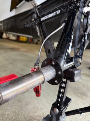

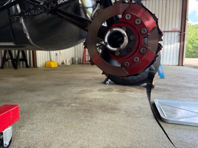

Now that @Cubonaut875 did a great job with all the leg work thanks to his A&P in getting Beringer to design the correct backing plate which he just installed and Beringer is sending me I think the dual calipers are hands down the way to go. Yeah, it's double the brake pads and an additional $1K+ for the upgrade itself but I want brakes that work and after all I went through with CubCrafters on this I'm glad mine work. I had my fittings and brake lines switched to Beringer's as CubCrafters rigs up some imperial to metric nonsense that is probably more room for pressure loss and sub par performance. I don't know why if you opt for Beringer's they don't use the correct Beringer hardware which I demanded and of course paid extra for. I actually had TacAero change my hardware to all Beringer post delivery in 2021.
I think the ultimate problem as well is 6 inch wheels/brakes are just not ideal for tires such as 31's. It's a shame the 8" wheels/brakes are not approved for 2K gross weight per Brian Bowen otherwise I'd switch to that and go with that other tire brand (can't remember the name) that's far cheaper but requires 8 or 10 inch brakes. The cost to switch though defeats that gain as it's 5K+ just to switch out the wheels/brakes. Yeah, money pit called aviation!

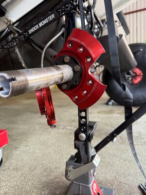

This is what the correct hardware looks like with a Beringer brake line to a single Beringer fitting that attaches to the brake. Compare that to the CubCrafters nonsense they installed. When you need proper pressure you need the correct hardware from Beringer, in my opinion!
My orientation is slightly different with an axle matched five hole backing plate.
I like that orientation. I’ll look to do that when I get the correct backing plate.
Notice the difference in fittings on yours if you zoom in. It’s because they used their own brake lines and fittings and not Beringer hardware. You pay this much and the “upgrade” to Beringers and get that half assed install. This issue has been ongoing since at least my Aug 2021 delivery. Seems no changes were made to resolve the poor performing Beringers.
Different angle showing all five bolts. I do like your banjo fitting, doesn't stick up as much.

As I was told by Yann at Beringer, they knew there was a problem with Carbon Cubs and Beringers early on due to the pedal geometry. A quick initial fix was doubling the number of calipers, hence the dual caliper systems that out there. All with the wrong backing plate.
After studying the problem they decided a solution of a smaller master cylinder, STOL brake pads and even suggested changing the pedal geometry. This solution would give a 30% increase in brake pressure. Since with the single caliper system on my plane as it was delivered, I would have to shift my heels up to the top of the brake pedals, push back in my seat just to hold for runup, 30% was not going to cut it. I was left with the choice of trying the dual calipers or dumping the whole system and going with the Grove wheels and brakes. Of course Beringer sent the wrong backing plate for the dual caliper system, that took two years to straighten out.
If I were you, I probably would go with the STOL pads. Beringer's test was on 29" Bushwheels for some odd reason. That extra 2 inches radius generates significantly more torque in my non mathematical opinion. Neal - do the math on that. I'll include the Beringer study for your information. The predomenent tire on Carbon Cubs, I would imagine, would be 31" Bushwheels. Whey they chose 29's if beyond me. And to top it off, I think they copied my paint scheme on their airplane.
