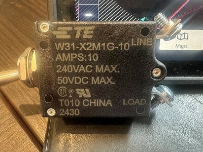

When you receive your replacement switch can you provide pictures of it? I'd like to try and get the brand used so I can maybe order a spare.
Wilco. Probably next 2 - 3 days.

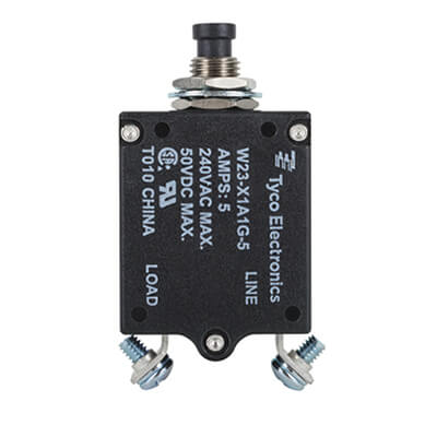

The link I provided in post #5 to aircraft spruce is the wrong product. We use the mini breakers, they are larger size breakers. I removed the link. I believe the correct breakers from Aircraft Spruce are the 2TC2 series. I requested a quote from CubCrafters parts and will likely order from them to ensure I receive the correct breakers for my spares kit.
Thanks Neal. Have you had may straight-up CB failures that requires a replacement? As a follow-up from my original post, I received a replacement 10A CB switch from CubCrafters, installed it and everything is working great so far. As requested, here is the part / part#. I plan to carry a spare in the plane just in case.
Glad to hear you're fixed up. I have not had a CB failure. I bet the risk is extremely low. I just don't want to find myself in the backcountry needing something and I'm stranded.
Here's a link to that switch on Aircraft Spruce if needed as well:

I ordered spare push pull breakers from CubCrafters. Price was reasonable. The 50A breaker is $315!!! So that's a no for me for the spares kit.
I realize I probably missed the ignition breakers on the front of the seat which I believe are 40A's? Doubt I'll get anymore, have what I have for now.
I was wrong, the ignition breakers forward of the seat are 5A.
Opened my package from CubCrafters and the packaging for breakers is all aircraft spruce so just buy direct from them.
