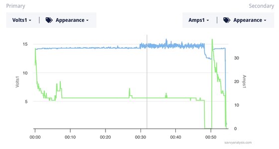

Well, well, well. Lookie here. Clearly there was some kind of irregularities in the alt field for approximately 18 minutes before the breaker popped. Resetting the breaker seemed to resolve the problem for the short remainder of the flight. Graph is of Volt1 and Amp1. Any ideas?

Three files attached. The file dated 12/15 ending with "KDTO" is the first flight of the day with no abnormal electrical indications. The file dated 12/15 ending in "KRPH" is the last flight of the day during which the ALT circuit breaker popped. Abnormal indications can be seen for approx. 18 minutes with VOLT1 at which time the CB popped. CB was reset which resolved the abnormal voltage indications for the few minutes left in the flight.
Lastly, the file dated today ending in "30F" reflects a lengthy run-up this morning after inspecting the alternator connection, battery connections and connections at the firewall terminal block (all were normal). This morning, I did as good of a visual inspection as possible - no abnormalities were noted. Note that I pulled the ALT CB during this run-up today just to observe the VOT1 indication with the breaker pulled. All appeared normal.
Any ideas would be much appreciated.

Good morning, all. Pete suggested I take the steps outlined in Service Bulletin XK-SB004 focused on improper hardware installed at the factory to attach the alternator wire at the alternator "B" terminal. Yesterday morning, I removed the cowling and did just that. Everything was tight, correct with zero signs of interference, arcing or any sort of abnormality. I traced the charging wire back to the firewall and all was normal. I checked connections to the main battery and starter relay which are located in the aft avionics bay. All connections were tight and normal. Buttoned everything up and did an extended ground run, which was normal.
The CC393 does not use the same EIS as the CC363. I believe my engine has the Lycoming EIS which does not have external coil packs.
@Cactus Charlie is still looking at the data files and may have additional thoughts. Unless he finds something to investigate, my plan is to take it to my avionics shop to install the Hall effect sensor that that @Cactus Charlie mentioned and also have the shop see if they can find anything. If nothing turns up, I'm going to fly it locally until the problem repeats. Recall that I upgraded my right ignition IBBS to a 6AH battery, so I'm confident I will be able to safely return to an appropriate maintenance shop in the event the breaker pops again.
