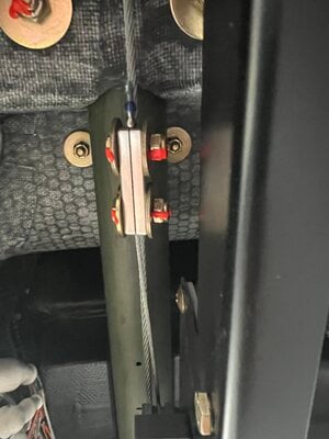

During my first 100 hour inspection I discovered a leaking AN fuel connection at the electric fuel pump filter even though I recall checking that I had torqued all those fittings -could have ended badly - The only other thing I discovered I had done wrong was not making sure the Elevator servo drive wire “cam” was centered exactly under the torque tube - easy fix. Learning to use a scope is not so bad and compression testing is straight forward.
I do not truest anyone touching my airplane as I once long ago had an off field landing when a well known engine builder did not tighten a connecting rod bolt correctly. The photo shows the cables before adjusting the servo.
