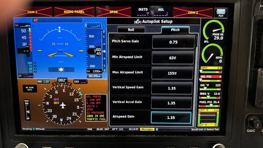

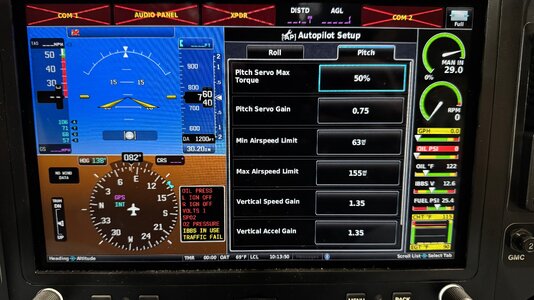

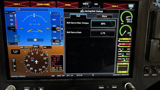

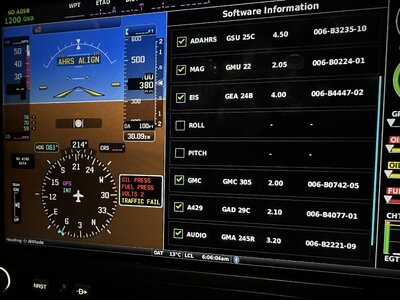

I’m in the process of troubleshooting autopilot drift, jerkiness and overall unsatisfactory performance smoothly holding course, altitude and glide path. This morning I noticed that the G3X shows that there is no software installed on the pitch and roll controls. Have no clue if this is normal, or if it’s an oversight at CubCrafters. Any thoughts or suggestions would be appreciated.
