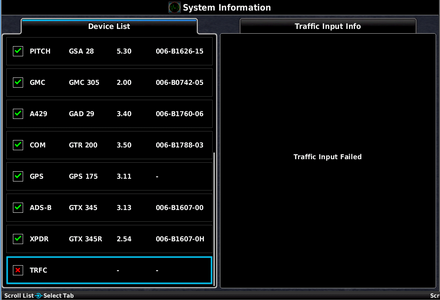

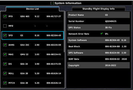

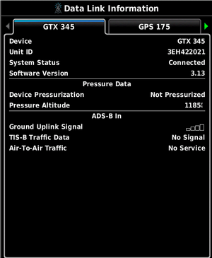

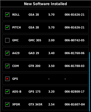

As to the topic of updating the transponder, I assume the version is on the G3X LRU list? I need to compare what I have installed vs what's available from Garmin.
Transponder information is available on several pages but the most detail is available in System Information. I don't have a screen shot of the expanded info for the transponder.
