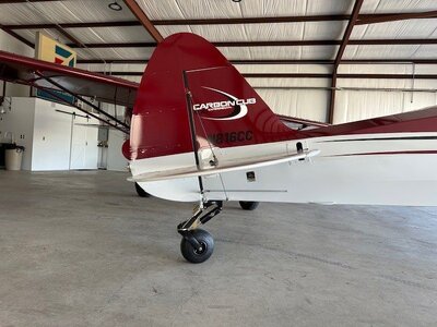

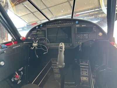

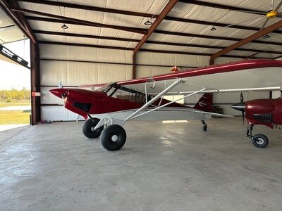

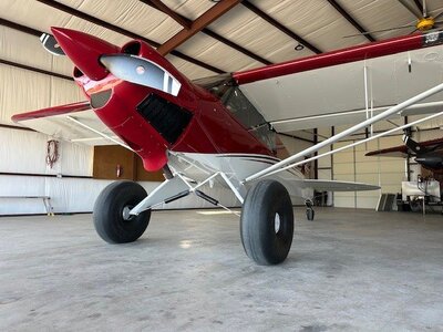

I've flown my NXCub for a little more than 8 months and ~ 100 hours and I just love it. It's a beast of a plane which has afforded me the opportunity to develop some basic Cub flying skills. Low, slow, short grass strips, windows open ... it's the most fun I've had in aviation ... so far. That said, the internal critic deep in my head constantly reminds me "yeah, that's all great, but it's not a tailwheel." So, after a few months of consideration, I've signed up to but a brand new EX-3 built by an experienced A&P/IA builder who I trust completely. I'm going to own the plane in partnership with my stepson. So this post is combo announcement and request for suggestions / recommendations.
2025 EX-3, CC363i, 83" 2-blade CS prop, 31" ABW, Acme suspension, 3x3 extended landing gear, ABW baby bushwheel with an IFR panel w/ AP, BEW of 1,169 lbs.
@Neal , I've watched just about all of your YT videos, but would appreciate it if you would point me the top 2 or 3 most relevant for a new EX-3 owner. Would also love everyone's opinion on whether the the following is worth the cost: (1) forward facing camera, and (2) dual caliper Beringer brakes.
Comments and suggestions welcome.

As to the brakes? No, you have grove which I am not familiar with but the brake issue I mention is for Beringer 6 inch wheels/brakes with 31" ABW. I could barely hold the tires at runup without dual calipers.

Your photos show a "stinger" tailspring which has adjustable caster angle. Also, Airframes Alaska will sell you a damper for over $1,000 and they have a video showing how effective it is. They also have exploded parts diagrams for the tailwheel and a guide on shimmy mitigation.

At least the last year of my life has been dealing with shimmy, maybe longer. I sadly am stuck to primarily pavement ops which as we all know is where the problem lies. My prior FX-3 had the T3 Tailwheel setup with the classic wheel/tire. I did have some shimmy issues and also made a video but got it resolved. The new plane I went with TK1's new shock monster tailwheel as I like TK1's products, Tony's humble attitude and amazing customer service and I believe in the durability of his product over others. My tailwheel has the 11x4-5 setup so it's a 11 inch tire. I learned from my CFI when expressing concern about messing up fields if going in when they're wet and he said it's not the main tires that do damage, it's the tailwheel, it becomes a plow. So I felt a larger tire/wheel would be a better neighbor for going in soft fields, wet or sand.
Every flight is a test flight for shimmy, land, make some adjustment. Yes, the caster angle is supposed to be most of it and I've gone extreme on caster and yeah, that works, however, too much caster makes the wheel want to rotate 180 degrees and now becomes a contributor to ground looping. So caster has it's limits too. I've tried high and lose tire pressure. No slack in the chains, which what Tony recommended too, to one link of slack. The problem with no slack is the shimmy transfers to the steering arm and you're going to damage something.
I recently loosened and retorqued, even changed the tire to a better Aero Classic tire over the one that Tony ships. Tony's shock is highly adjustable with upper and lower gas chambers allowing you to control the pressure to make adjustments as well as a main clevis. He's been amazing with customer service helping me with this, I know he wants nothing more than to never hear from me again but he hasn't blocked me yet! It seems as if I'm the only one with shimmy problems with his setup but quite frankly I'm probably in the minority landing on pavement of his customers, or no one else is vocalizing the problem as I am. I have swapped the tailwheel setup out for the T3 and shimmy is gone but I really want the bigger tire and of course I paid good money for this.
Trent Palmer has the same setup but a slightly larger tire but the difference is his is NOT steerable, he has no steering arm or link chains and springs. So I wonder if part of the problem is that I'm kicking rudder to keep the nose straight which is causing the tailwheel to touch down angled immediately kicking it into a shimmy? So last week I reached out to Tony with the idea of trying a non steerable setup. Mine is easily switched over by removing the steering arm and putting a spacer washer in its place which Tony sent me, as a courtesy, which arrived yesterday. So that's in the plan after a few more caster angle attempts to see if simply setting the tailwheel down straight has any effect. I hear about speed, etc. and I land 3 point all the time at the stall speed so I can't go any slower.
Maybe a darned stick for a tailwheel is a better idea like the good ole days? There was someone on one of the Facebook groups in recent weeks with his Carbon Cub SS (yellow) and the baby bushwheel sounding just like me, wanting to do anything to stop the shimmy. He's had it and is going from the bbw back to the standard Aero Classic tire. I may end up doing the same but I'm not there yet.
