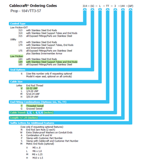

For those FX3 owners who have not had to remove the interior, left side panels for maintenance, I documented the the removal of my panels when I removed them to allow replacement of a failed propeller control cable (part number SP58011-007, $239 + shipping) I’ve been told a number of FX3’s have required replacement prop control cables early. Mine needed it at 413 hrs.

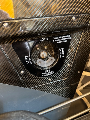

4 - The fuel selector switch needs to be taken apart before the middle panel can be removed. Having the diagram from the finish manual handy helps with the disassembly and assembly of this component. Unscrew and remove the selector switch. Note this took more effort then I expected it to. Its press fit as well as screwed in
5 - Remove the press gate. WARNING - there are springs behind each of the screws. Go slow and don’t lose these.
6 - remove the screws holding the carbon fuel select panel. Note there are small plastic washers behind each screw.
