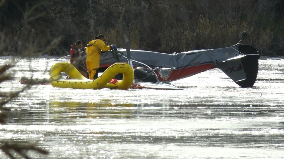

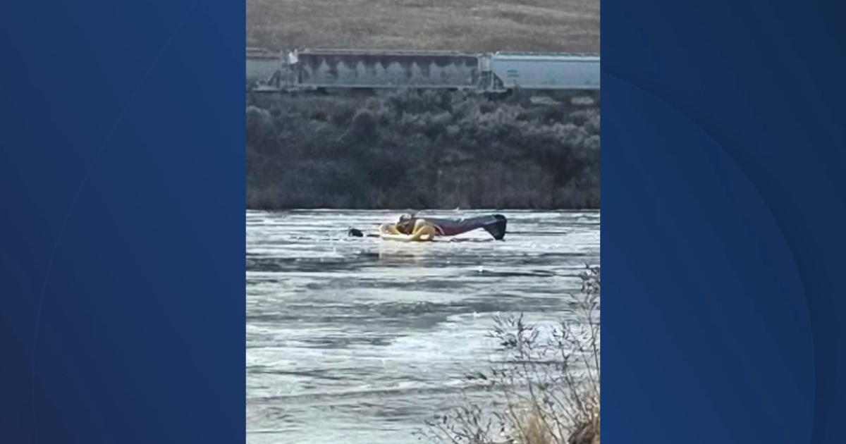

Looks like an early EX (CCX-1865-0016). ADS-B Exchange shows a single data point over the river but an approach that suggests to me that a low level run may have been planned.

If that last ADS-B position was correct, there is a power line crossing the river/lake at that location:
With no markings as far as Google Street View:
Any idea what the AGL of the obstacle was? I wonder if they had a BRS and immediately pulled would it have saved them?
The news reports mention that the plane "clipped" the power lines, so I would guess there was very little time to react. The CubCrafters docs mention as little as 100 ft AGL, but Cirrus says 580 ft AGL...
