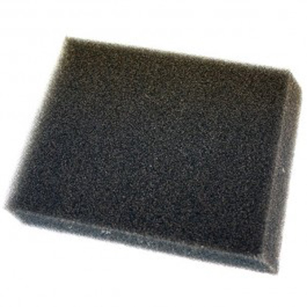

I was searching Aircraft Spruce yesterday and saw this ($14):
But I'm fine with paying CC if it's a precise cut and oiled properly but it's nice to learn the process should I want to do this on my own someday ahead.
BA6108 is far too small to be useful for FX-3.
There are all kinds of options if you search Aircraft Spruce. If you know the right one feel free to share for others. But not something I'll likely do with my inexperience. If anything I'd clean my existing and refurbish it.

Spruce provide a listing of Bracket filters and their replaceable elements here - Brackett Air Filters | Aircraft Spruce ®
The only one I found that may be useful is BA8305 which was referenced just a few posts ago. You need at least 12x8 inches to cut an FX-3 filter.
