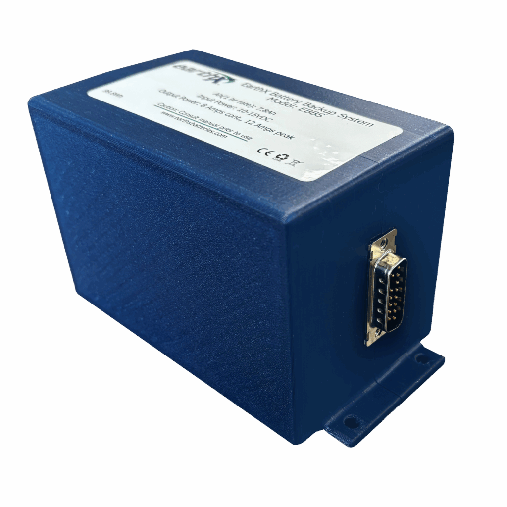

I haven't pulled my right interior panel yet to explore the EarthX backup battery option to see if it will fit. But I think we/I need to also not be forced into placing an ignition backup battery in that location. We should discuss alternate location ideas. I'd say there's plenty of room behind the panel as the EarthX backup battery I have fits in my hand. It could sit right behind the GDU with ease. The question is will it cause any type of interference? I'm not sure where the wires are running from to get to the right interior panel and how hard it may be to change that wire path.

So let's continue to work together to see what we can come up with as we all know we CANNOT depend on the quality of battery CubCrafters uses for the ignition backup battery. While spec wise a 2 AH battery should suffice, this battery has proven to degrade fast and not knowing if we are ever recharging it fully to maintain battery health is another concern. This is why I plan to add a pigtail that I already purchased to my EarthX backup battery so I can put it on a charger a few times a year as cell balancing is crucial to LiFePO4 batteries and I can't trust the aircraft charger to be properly maintaining it.
