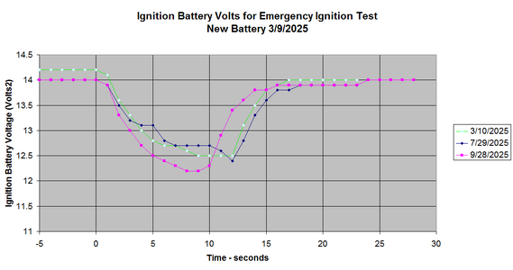

I run a 10 second test of the emergency ignition battery at every run-up. I watch the rate of voltage decay and I periodically plot the data. Over 5 years of FX-3 ownership I have collected a lot of ignition battery data. I have concluded that the emergency ignition battery is unfit for purpose (crap in plain English).
Even if replaced every year the new one may not last until the next change. These batteries are typically rated for 5 years in float charge standby applications but the longest I have had one last is about 18 months.

I have tried two methods to test my emergency ignition battery:
1. In flight test running at about 2100 rpm (my typical cruise) right ignition to emergency, left ignition normal. Monitor ignition voltage decay for 30 minutes. Return right ignition to normal. Take the SD card home and plot the voltage curve.
2. Observe ignition battery voltage during a 10 second emergency ignition test at every run-up. Periodically plot the voltage to see trend.
I only did method 1 once because I found the ignition battery charge current when the test was terminated exceeded the recommended maximum charge rate for the battery. I found that method 2 gave a good indication of battery health and did not abuse the battery.
The best way to test the battery is to remove it from the aircraft and run a loaded discharge test (at least 1 A discharge current) for at least 30 minutes. Record and plot the voltage. Then charge the battery and put it back in the aircraft. No one is going to do that as it's easier to replace the battery once a year. I have run this test on batteries I have taken out of service.
