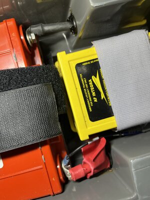

This what I have to work with getting to the positive terminal. Been nice if the factory would have placed the cable attachment outboard like the negative.
Yeah, it's a whole lot of not fun!
Removing the ELT makes it easier. Turn it off first obviously. You’ll get it, just takes patience.
