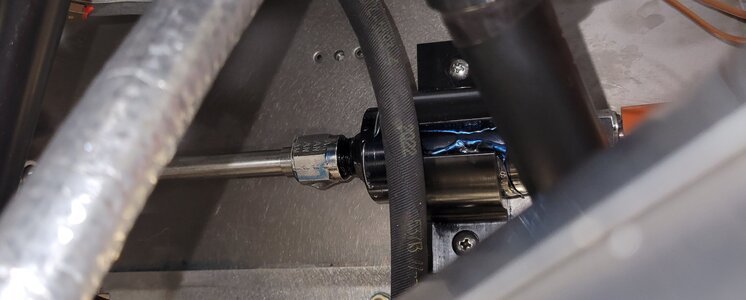

Looks like we are identifying a trend here with the aux fuel pump and the hard line connections. I removed my cowling after my battery issues and decided to go thru the engine sine I was down anyway. Found traces of leaks around the aux fuel pump on both sides of the aluminum pipe connecting it. Was able to snug it down fairly easily and hoping that was the issue. 20241222_184923.jpg
I know another FX-3 owner just had the same thing found on his condition inspection. Good catch!

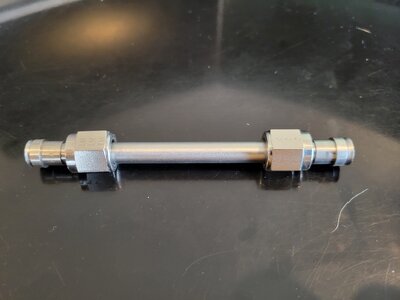

Further inspection led to this on the upstream side of the fuel pump. Sent all this info to Pete at CubCrafters support- they have been very helpful in the past- will shoot an update once I hear back.
I definitely had that issue also. Shortly after the plane was delivered my fuel pump quit, Neal actually caught it sounding funny in one of my videos. We replaced it, factory sent a new one. I think however, that it is not the easiest thing to change. The nuts on the screws are almost impossible to get to and I think that if the pump is not securely tightened to the firewall the fittings will eventually leak. It is definitely a two person job to change or even tighten. Buy some long screwdrivers for the job. It think anytime I have the lower cowl off I will definitly check the aux fuel pump. Also, the aux fuel pump is a hard to get item and frequently goes on back order. I have a spare that I purchased, $900.00 so if anyone needs one and they are on back order, let me know.

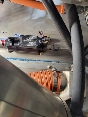

Pete from CubCrafters was quick to respond to this and we think this was the culprit. Around the time mine was built he mentioned the tooling was not as precise as the current set up. There were a few minor imperfections and a burr on one side. Both sides had leaks. They dropped another in the mail- I should be back in action in a few days. I notice on your firewall lower left side of the picture- camera jack I am assuming? I have one to install but haven't done it yet.
Yes, that is for the camera. By the way @Cubonaut875 that grommet where your camera wire goes through the firewall should be sealed. Nice path for CO there.
Wow! I hadn't noticed that! Did you seal yours with silicone!

No, all of the firewall seals use a high temp sealant I believe. I noticed some of mine needed some so I emailed CC (Pete) and learned that. I believe this is what I used based on my Amazon order history.
