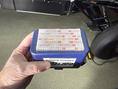

MOD Upgrading the ignition backup battery in a Carbon Cub FX-3
