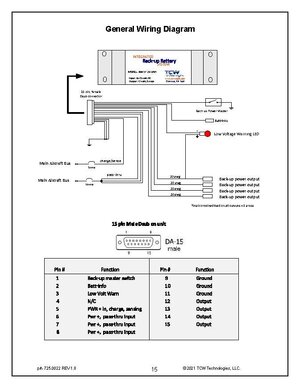

While I'm still testing the EarthX backup battery as outlined in this thread, I'll start a thread for those considering use of the TCW IBBS 3AH LiFePO4 battery. I welcome discussion on wiring required for a EX-3/FX-3 which the factory uses a 12V AGM battery, typically the PowerSonic P1221S which is a 2AH battery.

The FX-3 has a two position emergency ignition switch OFF/ON.
From my high level overview and not looking at the current schematic of the ignition backup circuit, hopefully someone can post that, it seems the current incoming positive would go to PIN 5 and the ground PIN 9. However, the difference here is the OUTPUT of the IBBS battery goes out 6,7,8 so this would require some wiring change so that output goes to the Light Speed Ignition. I'm interested in how that's currently wired and what would need to be changed to effect this battery upgrade.
Open to discussion and share knowledge to help others that may be considering this option.
Light Speed diagram below, others and manual attached.
