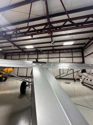

I have a factory-built Carbon Cub EX-3 with the "IFR" panel. There are lots of radios onboard (not counting my iPhone, iPad Mini, VHF handheld - Yaesu FTA-850, Insta360 ACE Pro 2 camera, Insta360 X4 camera, Garmin InReach Mini 2, LightSpeed H-Mod headset, etc.):
  • 2 VHF voice transceivers: a Garmin GNC 355A and a Garmin GTR-20 (mounted above the passenger's seat); the Comant VHF Communication CI 121 antennas for these are mounted as documented in the Dropbox "SK73000 Antenna installation.pdf" file.

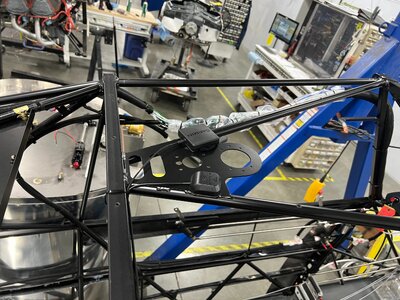

  • 4 GPS Receivers: Garmin G3X Touch (GDU-465), Garmin GNC 355A, Garmin G5 and an INTEGRA AF ELT; the GNC 355A external antenna is a Garmin G35A mounted as per the Dropbox "SK73000 Antenna installation.pdf" file; the GDU-465 external antenna is a Garmin GA26X (BNC) mounted inside above the pilot's seat on the frame bracket that holds the seat belt next to the SiriusXM antenna; the Garmin G5 is using it's internal antenna under the panel (works fine) and the ELT is using it's internal antenna under the pilot's seat (works fine).
  • 1 Sirius XM Receiver: Garmin G3X Touch (GDU-465); this uses a Garmin GA24TNC antenna mounted inside above the pilot's seat beside the GDU-465 GPS antenna.

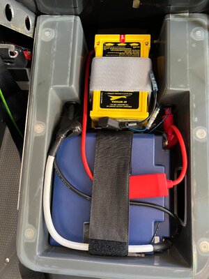

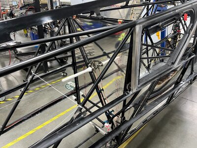

  • a 121.5/406 MHz transmitter in the INTEGRA AF ELT; the antenna is mounted horizontally behind the extended baggage.
My testing, which used a movable GPS antenna temporarily connected to the GDU 465, showed significant attenuation of the GPS signal when that antenna was placed close to the ELT under the pilot seat. Not surprising since CF is known to be an RF attenuator.
I concluded that the ELT's built in GPS receiver would have delayed or no position acquisition after a crash. I had intended to give the ELT a serial data GPS feed but never got round to it.
How did you determine that the ELT internal GPS antenna "works fine"?
That was my assumption, and I'm sure that the signal is significantly attenuated. I had an incident (with basically no damage to myself or the plane) in which the ETL was automatically triggered. I disabled the ELT about 7 minutes after activation when I got off the 911 call. About 9 minutes after activation, I received a call from the Canadian Coast Guard, and the officer on the line already had my location. I am not 100% sure how much of this location was from triangulation and how much from the GPS, but the ELT did work and provided a location.
I too, plan to wire up the cable because in a crash, the location of the ELT might not be the location that it was in before the crash, e.g. the front of cabin underwater (where ELT is) before tail (where the VHF/UHF antenna is), so it is vitally important that the first ELT transmission contains the GPS data. In my incident, the plane was not underwater, so the GPS receiver could work, and the ELT continued transmitting until I disabled it.
Real-life experience :-) In retrospect, I think having my Garmin InReach Mini 2 and my iPhone in my pocket is much more useful than the ELT - being able to coordinate with the responders really cut down the time it took them to get to my location.
