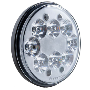

I have a taxi light on/off switch on my panel on the lower left of the G3X area with a 5A fuse. As the wing leading edge lights point up while taxiing the light for taxiing at night will be minimal. I've done it, it's doable but I wanted better so I installed a taxi light. On my prior FX-3 I used a 10 inch RIGID light which worked fine but when at EAA AirVenture 2023 I looked at the Whelen lights and noticed the dedicated taxi light as used in many nosewheel aircraft. The specs looked good and the gears starting turning in what I wanted to use in my new FX-3.
Not a cheap setup but I decided to pursue the Whelen option over the RIGID light bar.
wat.pngwhelen-mount.png​
Whelen Parmetheus™ G3 PAR 36 Landing & Taxi Light FAA-PMA | Aircraft Spruce (be sure to choose the taxi light option, not landing light)

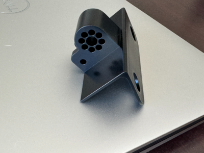

Now the question is, as always, how to mount it. As I enjoy CAD design and 3D printing I designed a mount that attaches to my cabane vee. Works outstanding and the light can be retracted when not needed (manually! I'm not Patey!). I probably won't retract it, I don't think the drag is a big deal or a concern to me, if much at all.
After deciding on my design and several 3D print tests I used a CNC service (Xometry) to send my design off to be CNC'd out of aluminum and double black anodized. As it didn't cost much more to get 10 vs. 1 made I got 10 made which cost about $1k. So I have 9 extras if anyone wants one.
light-mount.png​
The end result came out amazing, the light works amazing and I love the setup. Initially I didn't paint it black and left it white but after the bullying by several friends I caved and painted it black :) I have to say they were right, but don't tell them!

Actually, The best location for any taxi lighting is DOWN LOW, this gives the best Beam useful performance, similar to fog lights on a car. In or on a wing works but is far from optimal for the best on the ground illumination.
BTW if looking for the brightest BY FAR LED landing and taxi lights on the market, take a look at XeVision. 2-3X brighter than anything on the market world wide.

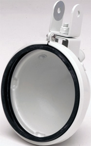

Also, the cup shaped unit is a legacy unit designed when only incandescent lights existed (incandescents don't "care" about heat) using it to mount the LED light unmodified will trap the heat from the heatsink fins on the back of the unit, they get up around 200 degrees F when not "trapped" from air flow. Being smart, you will remove most of the rear of the "cup" metal to expose all the fins to the turbulent air around it.
Otherwise in 5-10 minutes you'll loose ~50% of the light output as it throttles back to protect itself from thermal runaway and self destruction. Please trust me on this.
That unit was "standard on new Beechcraft aircraft, "many moons ago" !

The cabane mounted taxi light appears to be directly in the exhaust stream. Has contamination of the lens with exhaust deposits been a problem?
It does require cleaning at times. Something to do when you know you're going night flying and keep that in mind.
