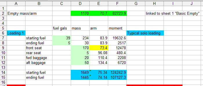

I maintain my equipment list and W&B using the same CubCrafters template. When the equipment list is updated the same weight and balance information is in the spreadsheet that calculates my flight weight and balance. The stuff that stays in the aircraft is in that spreadsheet not the equipment list.

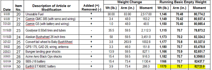

Interesting. I see now the rack items are accounted for in a basic operating weight along with pilots. Of note, your equipment list has individual weights and arms for the "standard" equipment. Mine didn't from the factory.

Not sure what you mean by "rack items". I initially assumed you were referring to the forward and aft baggage compartments.
The addition of a new radio, or changing a radio to a different type, would require a change to the equipment list and, unless declared as negligible, an update to empty mass, arm, and moment.
It is only items added after weighing that show individual mass, arm, and moment. Page 1 of my equipment list does not have these individual mass, arm, moment entries. My page 1 ends with "as weighed - mass, arm, moment.
The Dry Weight entry in your equipment list is equivalent to my page 1 "as weighed" entry.
