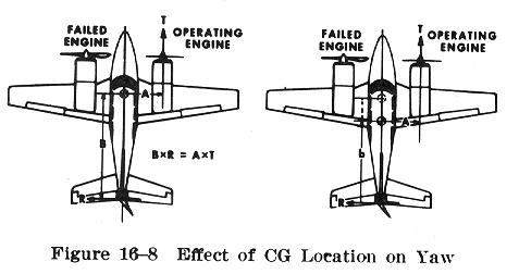

Vmc is greater when the center of gravity is at the rearmost allowable position. Since the airplane rotates around its center of gravity, the moments are measured using that point as a reference. A rearward CG would not affect the thrust moment, but would shorten the arm to the center of the rudder's horizontal "lift" which would mean that a higher force (airspeed) would be required to counteract the engine out yaw. Figure 16-8 shows an exaggerated view of the effects of a rearward CG.
http://www.faatest.com/books/FLT/Chapter16/Vmc%20Demonstrations_files/imageI1M.jpg Questions?

The variation of the minimum control speed (Vmc) with weight is closely related to the 5 degree AoB limit set down in the rules when determining Vmc.
As I'm sure you're aware when you bank "five to the live" or "raise the dead" there is a small horizontal component of lift (a force) which is added to the force produced by the rudder. The horizontal component of lift supplements the force produced by the rudder and aids in maintaining directional control to counteract the assymetric thrust/drag. So for a given assymetric thrust condition, when a bank is introduced the force produced by the rudder can be less which translates to a lower Vmc.
There are a couple of reasons the regulations impose the 5 degree AoB limit for determining Vmc:
Firstly banking 5 degrees has a negligible impact on the vertical lift generated to oppose weight (the exact amount can be worked out with trigonometry) which means elevator forces are minimal.
Secondly if the 5 degree rule didn't exist it would be possible for manufacturers to publish a Vmc figure which was much less. Obviously, ignoring stall speeds, if you were able to bank the aircraft to 30 degrees, that horizontal component of lift which is supplementing our rudder is now much greater, so the rudder force required is even less which, again, translates to a lower Vmc. The problem with this is the non-practical or unrealistic handling methods which would needed to be used in the event of engine failure (ie: significant angles of bank, large elevator forces etc...)
Hopefully some of the above makes sense, and if it does it should be clear that for a heavier weight that horizontal component which is helping our rudder is going to be greater, which means less force needed from the rudder which means less airflow over the rudder which means lower Vmc.
