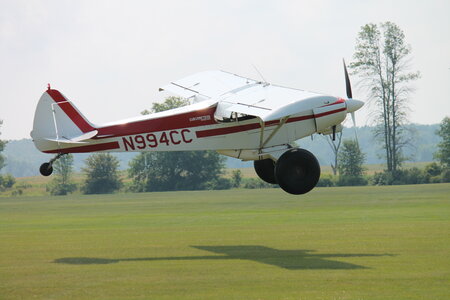

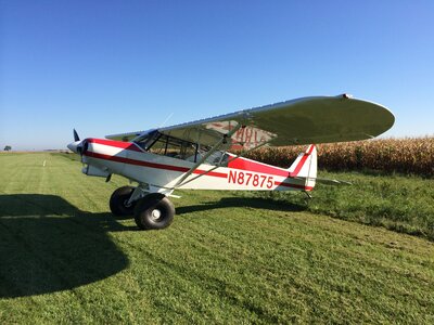

I pondered this question with the Tac Aero people and we came to the conclusion it had something to do with the plane not breaking in the power off stall and mushing down without a break. Logically I could not figure it out. However, not cleaning bugs and mud from them has been a treat. My PA18 had Micro VG's on the underside of the stab in just the right position to catch bugs and dirt. The alternative I have seen are strakes forward of the stabilizer. You can see the strake on I believe Steve Johnson's plane from New Holstein 2013. I would be hesitant to add them as the plane is exceptional in the stall as it is. Also the wing VG's are not in a straight line on the FX3 as they are on a PA18 with Micro VG's. Not sure why on that either but it seems to work.
