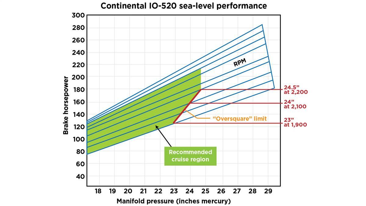

Found this video from Savvy on Over Squared flying

Follow Savvy. We were all taught wrong back in the day, and unfortunately that has been long lasting. There is no need to reduce manifold pressure before bringing back the prop to 2500. There is also nothing wrong with leaving full power until TOC.
My first employer (US Check) back in 1993 corrected me on the bad habit of setting power square while flying Barons and Aerostars.
Taught wrong? Maybe. Misunderstood is more likely.
All one has to do is look at an airplane manual, even an old one, for a constant speed prop to know that “over square” is only a problem when they are way off.
Prop first to increase/MP first to decrease is the same. It’s to avoid things getting out of whack if you are going to reduce or increase both. It has nothing to do with maintaining climb power while reducing prop 100-200 RPM for noise and vibration. Never really did.
When I first started flying constant speed props, like most of us, I was taught to always fly under squared. But since reading Mike Busch's books I'll typically fly over squared unless I'm flying equal. In either case manifold/RPM was always within 2 in/2000rpm.
