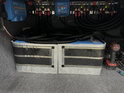

LiFePO4 batteries typically have an internal battery management system (BMS) or an external BMS such as in my motorhome (RV) as pictured below. The company that installed it has a person that custom makes 12V heating pads that wrap the compartment and is controlled by a temp sensor (Ruuvi bluetooth device) and connects to a Victron device that can sense the temps and turn on/off a relay that controls the heating pads. Not an option to be this elaborate in an aircraft typically but with EarthX etc. on the rise in adoption, heat needs to be part of the solution. The BMS will prevent damaging the battery (hopefully) by preventing charging when the temps are out of limits. There has been discussion that the optimate charger is temperature aware, I have not personally read that and I'm not sure if it does or not, the battery typically controls via the BMS whether it can take a charge or not. The charger and battery may be different temperatures so I personally would not want the charger doing the decision making, the battery (BMS) needs to do that.

So how can you handle this temperature issue? If I lived in a cold climate like Siberia Minnesota or Alaska I would find a 12V heating pad and control it by a rocker switch which is easy to install. You'd need to fabricate some type of mount for it. But there is no reason the EarthX itself can't power its own heater, again, it can discharge below freezing, it just can't be charged. So if you can get the temp up on it then it will take a charge. I did a quick search for 12V heating pads for LiFePO4 batteries and there are options out there. There are also 120V options where you could just plug one in like your engine pre-heater. Just think through the scenarios of when/where you may need heat and ensure you have the ability to heat the battery while away. Fortunately my plane (FX-3) has good heat but if you are flying in a situation where you can't get the inside of the airplane above freezing then it's not going to charge even while in flight which is not a good thing, you need a heating solution to resolve this problem. Ideally EarthX should offer a battery with an internal heater like other brands offer. Nag them to make it happen and I haven't checked to see if they offer anything yet, maybe they have an answer to the problem but I'd reach out to them. When I inquired about this problem a year or so ago they said starting the airplane will generate heat within the battery. I personally don't agree with this as a solution to this problem.
