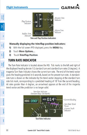

I don't recall seeing this before 9.22 but maybe it was there and I never noticed. I have no waypoint or flight plan active, just flying local with nothing selected at this time for navigation. Anyone know what this dashed line is for pointing to the purple marker, which I also don't know what is for? (Disregard the IBBS IN USE message, a known issue that means nothing but we can't seem to find the wire issue "yet").
Reviewed the latest docs and it's the current track indicator. As all of this is new to me this is something I need to keep reading over and over to digest slightly more each time. A lot of little nuggets built into these fancy panels.
