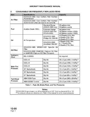

I think a key element in the above equation is Continental vs. Lycoming. I'm no expert at any of this but it appears CubCrafters guidance at least is Philips for their Continental engines and Aeroshell for the FX-3's Lycomings.
